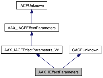

Inheritance diagram for AAX_IEffectParameters:
Inheritance graph

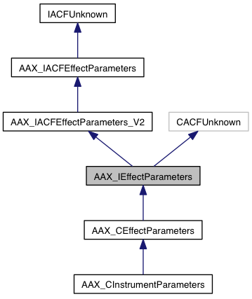

Collaboration diagram for AAX_IEffectParameters:
Collaboration graph

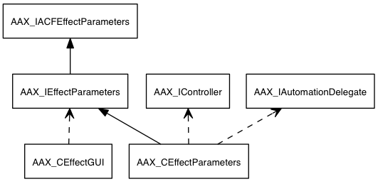

Related classes
Classes related to AAX_IEffectParameters by inheritance or composition
Classes owned as member objects of AAX_CEffectParameters
