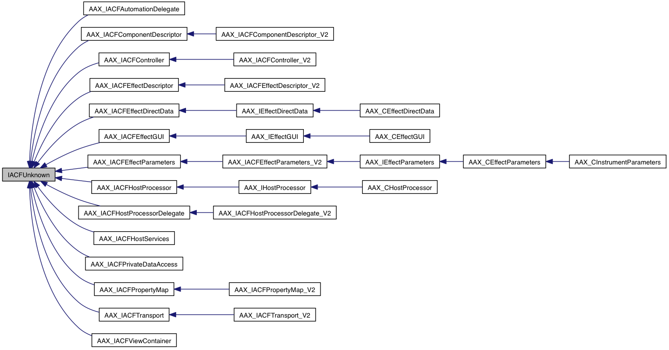

Inheritance diagram for IACFUnknown:
Inheritance graph
