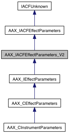

Inheritance diagram for AAX_IACFEffectParameters_V2:
Inheritance graph
[legend]
