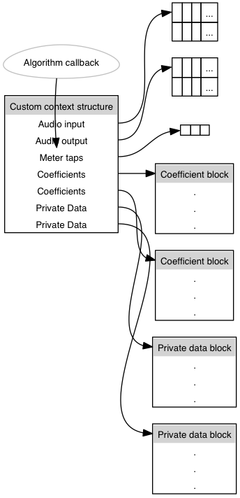

Algorithm memory management
This callback pattern is designed such that plug-in algorithms may be easily loaded in remote memory spaces on a variety of devices and quickly re-compiled for different operating environments without significant changes to the code, and this design goal informs the algorithm's memory management techniques.
When the AAX host calls a plug-in's algorithm callback, it provides a block of memory describing the state of the plug-in. This block of memory, known as the algorithm's context, can be thought of as the algorithm's interface to the outside world: when another part of the plug-in interacts with the algorithm, it does so by posting information to the algorithm's context.
// Component context definitions
// Context structure
struct SDemoDist_Alg_Context
int32_t * mCtrlBypassP; // Coefficient message destination
float * mCtrlMixP; // Coefficient message destination
float * mCtrlInpGP; // Coefficient message destination
float * mCtrlOutGP; // Coefficient message destination
SDemoDist_DistCoefs * mCoefsDistP; // Coefficient message destination
SDemoDist_FiltCoefs * mCoefsFiltP; // Coefficient message destination
CSimpleBiquad * mBiquads; // Private data
float* * mInputPP; // Audio signal input
float* * mOutputPP; // Audio signal output
float* * mMeterTapsPP; // Meter signal output
It is important to note that, in most circumstances, algorithm callbacks do not own their own memory. The algorithm and its memory is managed entirely by the host or shell environment, and relies on the host-provided context structure for all state information.
If persistent memory is required, algorithms can register for block(s) of persistent state date via the AAX_IComponentDescriptor::AddPrivateData() API (as in SDemoDist_Alg_Context::mBiquads above.) A plug-in may store state data in the resulting "private data" context fields and this data will be restored by the host when the algorithm is next called. See the Persistent algorithm memory section below for more information.

Collaboration diagram for Real-time algorithm callback:
