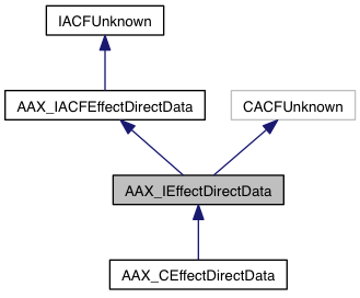

Inheritance diagram for AAX_IEffectDirectData:
Inheritance graph
