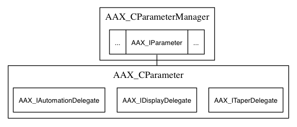

In AAX, individual parameters achieve their own unique behavior by being associated with behavioral delegates.
For example, when AAX_CParameter::SetNormalizedValue() is called on a particular parameter through its AAX_IParameter interface, the AAX_CParameter calls into a AAX_ITaperDelegate that it owns in order to convert the normalized value to its real equivalent. This real value is then set as the parameter's new state.
For more information about how delegates are used to create a parameter's behavior see AAX_CParameter

Collaboration diagram for Parameter Manager:
