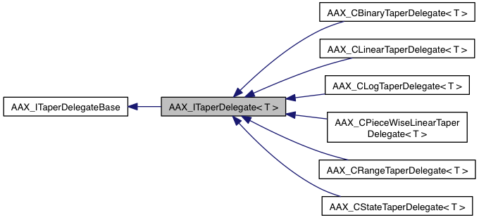

Inheritance diagram for AAX_ITaperDelegate< T >:
Inheritance graph
[legend]
Collaboration diagram for AAX_ITaperDelegate< T >:
Collaboration graph
[legend]
