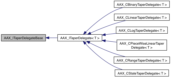

Inheritance diagram for AAX_ITaperDelegateBase:
Inheritance graph
[legend]
