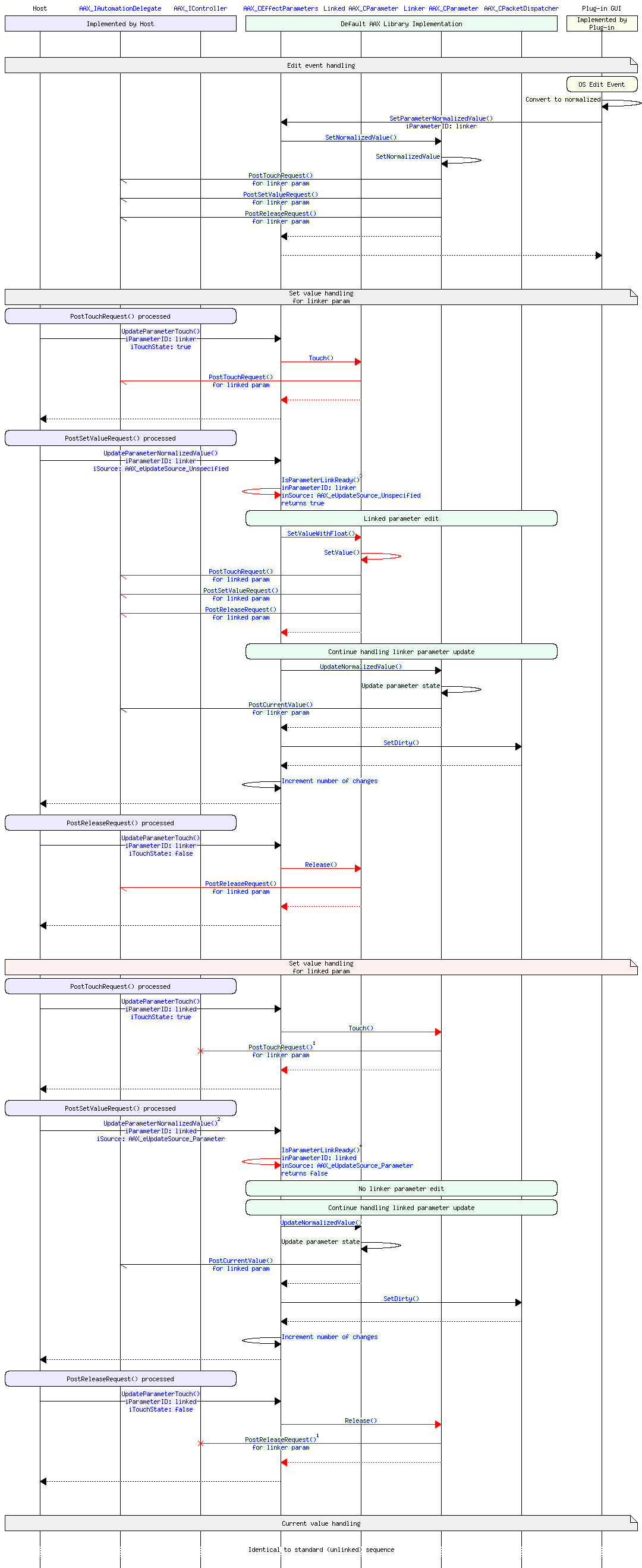

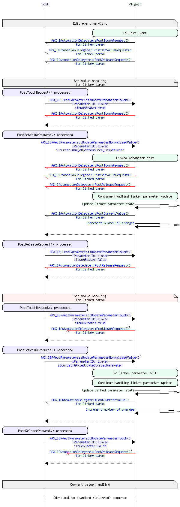

High-level interface calls and events
msc_AAX_LinkedParameterUpdate_GUI_HighLevel
High-level sequence of interface calls and events for a reciprocally linked parameter update following a user-generated edit
linkedParameters_sequences_user_gui_detail
Note that this diagram assumes a GUI implementation that uses SetParameterNormalizedValue(). The implementation could also use other parameter set methods, either in AAX_IEffectParameters or directly on an AAX_IParameter. The overall sequence would remain the same.
Detailed sequence of method calls and events for a reciprocally linked parameter update following a user-generated edit on the plug-in GUI

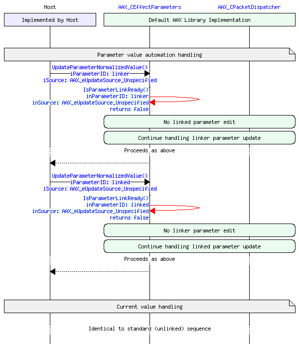

Update from automation playback
Since all parameter linking occurs while recording automation, automation playback is very simple. The automation lanes may contain any arbitrary values, so, in order to avoid fighting between incompatible values, the plug-in should respect all automation values during playback.
Notes:
  1. IsParameterLinkReady() returns false during automation playback because the updated parameter is not touched. This ensures that automation playback will proceed with the written values and also guarantees that the user will always be able to override the automation using a control surface encoder or GUI editor.
msc_AAX_LinkedParameterUpdate_Automation
Sequence of method calls and events during automation playback with linked parameters
