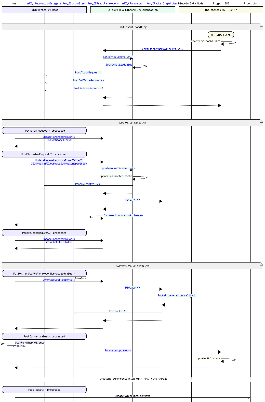

Detailed sequence for default implementation
Note that this diagram assumes a GUI implementation that uses SetParameterNormalizedValue(). The implementation could also use other parameter set methods, either in AAX_IEffectParameters or directly on an AAX_IParameter. The overall sequence would remain the same.
msc_AAX_ParameterUpdate_GUI
Detailed sequence of method calls and events for a parameter update following a user-generated edit on the plug-in GUI
