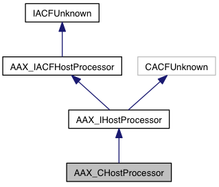

Inheritance diagram for AAX_CHostProcessor:
Inheritance graph
[legend]
