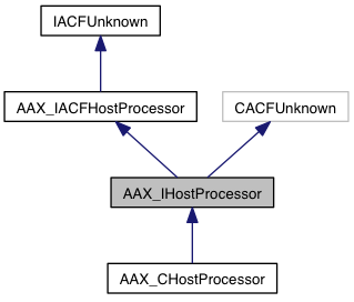

Inheritance diagram for AAX_IHostProcessor:
Inheritance graph
