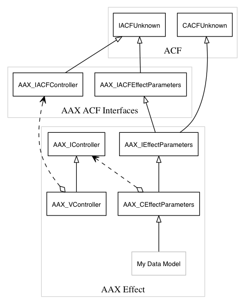

ACF interfaces: AAX_IACFEffectParameters and AAX_IACFController
The figure above demonstrates this design: the plug-in implements AAX_IACFEffectParameters directly, and retains a reference to an AAX_IACFController that is implemented by the host.
In order to implement AAX_IACFEffectParameters, AAX_IEffectParameters inherits from CACFUnknown and implements QueryInterface() to ensure that the IACFUnknown interface is implemented. The rest of the implementation of AAX_IACFEffectParameters is contained in AAX_CEffectParameters and the plug-in's custom data model class.
The reference to AAX_IACFController is managed by a versioned implementation class. For more information about this design, see below.

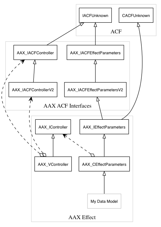

First, here is a more complete picture of "version 1" of the AAX_IACFEffectParameters and AAX_IACFController interfaces, including a possible host implementation of AAX_IACFController :
ACF interfaces: AAX_IACFEffectParameters and AAX_IACFController (with possible host design)
To extend these interfaces, new "version 2" interfaces are created that inherit from the original interface classes. Although any version 1 method could be called on the new version 2 class, references to each interface are retained by the client in order to clarify the specific version in which each method was introduced.
Adding a new version to AAX_IACFEffectParameters and AAX_IACFController
In this example, if the plug-in is loaded by an older host, the reference to AAX_IACFControllerV2 will return as NULL, and calls to the V2 methods in AAX_IController will return an "unimplemented" error code. Similarly, if a plug-in that only implements AAX_IACFEffectParameters is loaded into a host that supports AAX_IACFEffectParametersV2, that host will receive a NULL reference to the newer interface version and will only be able to call methods on the plug-in's implementation of the original interface.

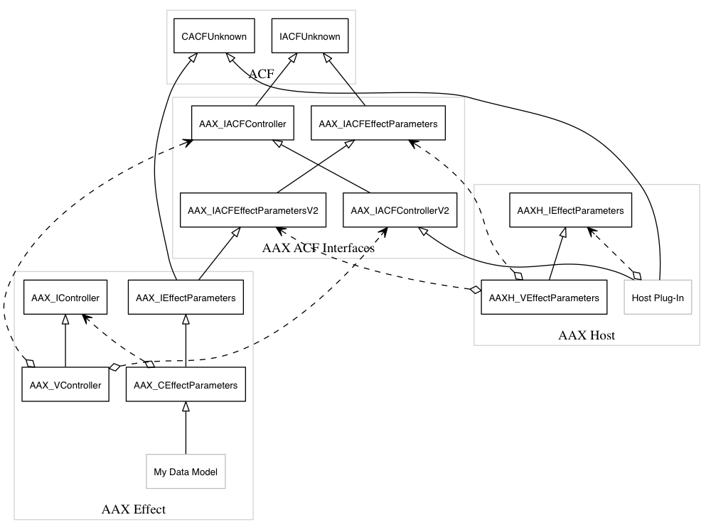

As a final example, here is a possible design involving new versions of both AAX_IACFEffectParameters and AAX_IACFController, with an example design for the host's implementation as well as the plug-in's:
Complete design example with versioned ACF interfaces
