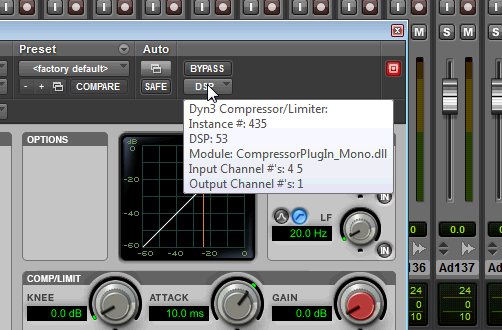

With a few exceptions, AAX DSP plug-ins will share DSPs with other plug-ins. This occurs transparently to the plug-in due to the fact that all system resource management is handled by the TI Shell.
When a new plug-in instance is created, the TI Shell and AAX host will attempt to intelligently allocate it to a DSP based on both memory and CPU resource requirements. If one plug-in on the chip requires a large amount of memory and very few processing cycles, it may be packed with another plug-in that does not require much memory but that is very CPU intensive.
The exceptions to this model are plug-ins that use DMA, register for a background processing callback, register a maximum number of instances per chip or use a processor affinity constraint when reporting CPU requirements. With the exception of a processor affinity, these plug-ins will receive dedicated DSPs to which only additional instances of the same plug-in type will be added.
- Host Compatibility Notes:
- Beginning with Pro Tools 10.2, the TI shell supports a "processor affinity" property, which indicates that a DSP ProcessProc should be preferentially loaded onto the same DSP as other instances from the same DLL binary. This is a requirement for some designs that must share global data between different processing configurations.
Note that this property should only be used when absolutely required, as it will constrain the DSP manager and reduce overall DSP plug-in instance counts on the system.

DSP information tooltip
Pro Tools can display additional information for DSP plug-ins using a tooltip in the plug-in window header. To display this tooltip, hold cmd-opt-shift (ctrl-alt-shift) and hover the mouse cursor over the DSP > Native button in the plug-in header.
The information in this tooltip is generally targeted at systems-level debugging, but can prove useful for some plug-in troubleshooting as well.
Figure 1: DSP tooltip in the Pro Tools plug-in window header.
