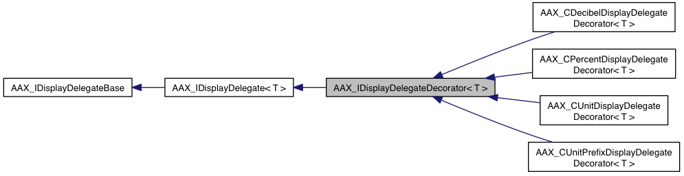

Inheritance diagram for AAX_IDisplayDelegateDecorator< T >:
Inheritance graph
[legend]
Collaboration diagram for AAX_IDisplayDelegateDecorator< T >:
Collaboration graph
[legend]

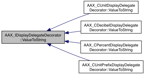

Referenced by AAX_CUnitDisplayDelegateDecorator< T >::ValueToString(), AAX_CDecibelDisplayDelegateDecorator< T >::ValueToString(), AAX_CPercentDisplayDelegateDecorator< T >::ValueToString(), and AAX_CUnitPrefixDisplayDelegateDecorator< T >::ValueToString().
Here is the caller graph for this function:

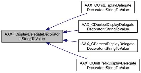

Referenced by AAX_CUnitDisplayDelegateDecorator< T >::StringToValue(), AAX_CDecibelDisplayDelegateDecorator< T >::StringToValue(), AAX_CPercentDisplayDelegateDecorator< T >::StringToValue(), and AAX_CUnitPrefixDisplayDelegateDecorator< T >::StringToValue().
