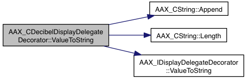

Implements AAX_IDisplayDelegate< T >.
References AAX_CString::Append(), AAX_CString::Length(), and AAX_IDisplayDelegateDecorator< T >::ValueToString().
Here is the call graph for this function:

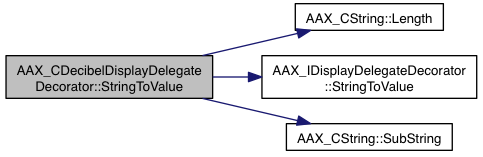

References AAX_CString::Length(), AAX_IDisplayDelegateDecorator< T >::StringToValue(), and AAX_CString::SubString().
