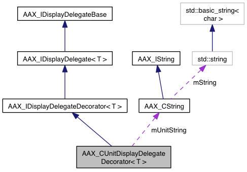

Collaboration diagram for AAX_CUnitDisplayDelegateDecorator< T >:
Collaboration graph
[legend]

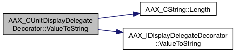

template<typename T >
bool AAX_CUnitDisplayDelegateDecorator< T >::ValueToString ( T  value,
int32_t  maxNumChars,
AAX_CString *  valueString
) const
virtual
Converts a real parameter value to a string representation using a size hint, useful for control surfaces and other character limited displays.
Parameters
[in]valueThe real parameter value that will be converted
[in]maxNumCharsSize hint for the desired maximum number of characters in the string (not including null termination)
[out]valueStringA string corresponding to value
Return values
trueThe string conversion was successful
falseThe string conversion was unsuccessful
Implements AAX_IDisplayDelegate< T >.
References AAX_CString::Length(), and AAX_IDisplayDelegateDecorator< T >::ValueToString().
Here is the call graph for this function:

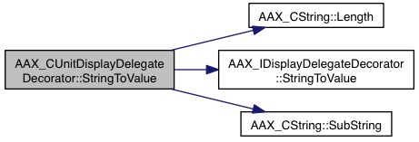

bool AAX_CUnitDisplayDelegateDecorator< T >::StringToValue ( const AAX_CString &  valueString,
T *  value
) const
virtual
Converts a string to a real parameter value.
Parameters
[in]valueStringThe string that will be converted
[out]valueThe real parameter value corresponding to valueString
Return values
References AAX_CString::Length(), AAX_IDisplayDelegateDecorator< T >::StringToValue(), and AAX_CString::SubString().
