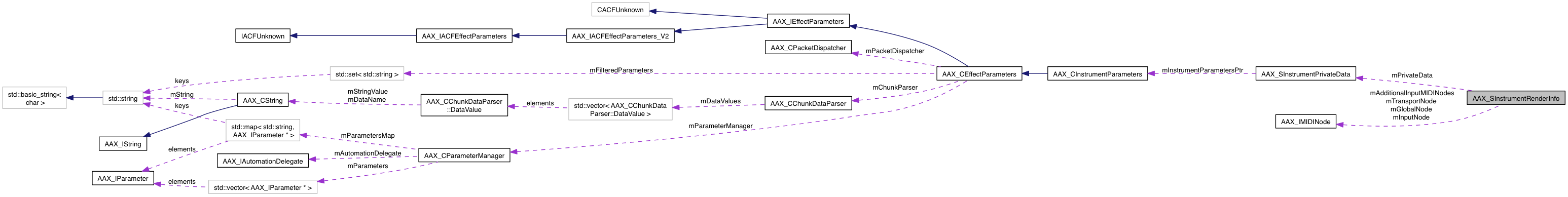

Collaboration diagram for AAX_SInstrumentRenderInfo:
Collaboration graph
[legend]
