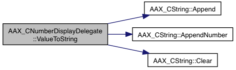

References AAX_CString::Append(), AAX_CString::AppendNumber(), and AAX_CString::Clear().
Here is the call graph for this function:

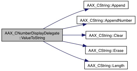

References AAX_CString::Append(), AAX_CString::AppendNumber(), AAX_CString::Clear(), AAX_CString::Erase(), and AAX_CString::Length().
