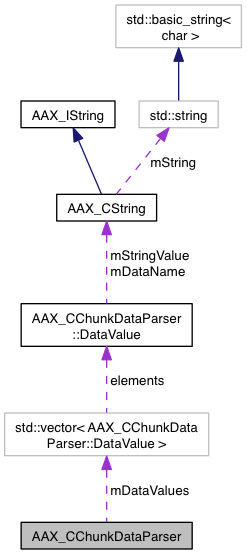

Collaboration diagram for AAX_CChunkDataParser:
Collaboration graph
[legend]
